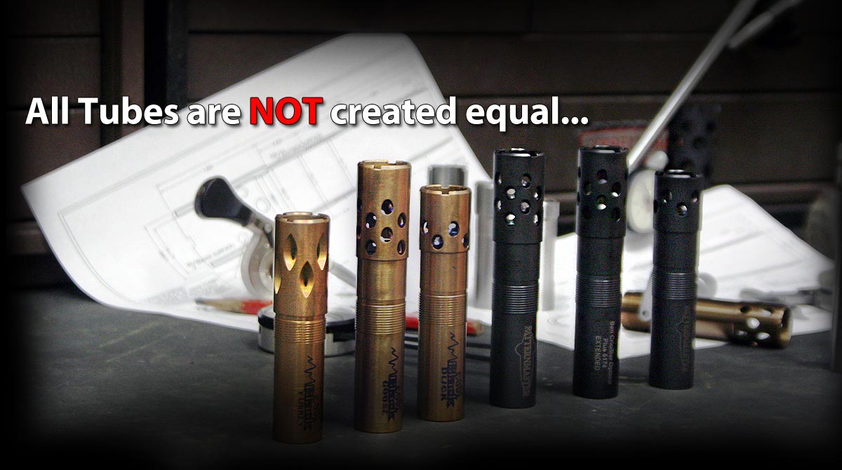

CoreWall
4-1-2014 13:12 CoreWall
Tru-Choke Choke Tubes.
Carlson's
